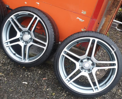

Hi , I have a 2007 1.8 Kompressor , fab looking car , on standard Rims , looking to move to 19 inch amgs ...... will they fit ? will I need centre Rings ??
Thanks Ken

Welcome Ken :) In order to answer your query, a little more information is required. The current wheel size, width and offset (all info found on the inside of the wheel, something like 17 x 7j ET37), the current tyre size.
The same for the new ones.
If the wheels have a A 211 ... ... part number on the inside spoke they will fit.
Generally you can fit a larger diameter alloy provided its from the same model (W211 E class in your case)
@AMGeed, the wheels the op wants to fit look like reps of the forged versions found in the E/CLS.
They are blanked out where they should be embossed with the AMG lettering.
Ah right.:doh: When the OP stated 19" AMG wheels I assumed they were OEM.
In that case lots of variables including ET, bolt type (radius or tapered) etc.
Lots more info needed on what is being fitted.
19's will fit, but the et or back spacing will determine whether u need spacers or not.... I've got 19's on mine, fit ok, but I did space but that was just for cosmetic appeal...
19's will fit, but the et or back spacing will determine whether u need spacers or not.... I've got 19's on mine, fit ok, but I did space but that was just for cosmetic appeal... Also check your lug nuts are the correct length..
