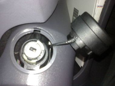

A car that has a chip in the fob has a device around the ignition , its called a transponder coil, you can see one, similar to yours, about ¾ way down this page here… Bert Rowe's-A-class info. Hazard warning, car keys, re-synchronizing remote keys, Central locking.
Without this chip you wont be able to bypass the immobiliser, you may have no choice but to buy a replacement key from a Mercedes dealer unless someone here knows of another solution.

Just out of curiosity... we have determined that i dont have the transponder to the fob
so why isnt the red/green lights not flashing when i try to start the car?
That’s what I’m not so sure about now, up to about January 1996 there were no chips inside the key, unlocking the car, with the remote fob, disabled the immobiliser so the car would start.
If the remote fob failed for some reason then the car would not unlock and so if it didn’t unlock then the immobiliser would not disarm and so the car would not start and the Red and Green LEDs would flash ALTERNATLEY to show that the immobiliser was not disarmed.
After January 1996 the chip and the coil around the ignition was introduced, so, as in your case, no chip – no start… what I’m not sure about, is whether the Red and Green LEDs in the mirror should still flash if the chip is missing as we think it is in your case.
Remove the coil, it seems to just “slot in”, as illustrated in my last link… if you do indeed have a coil then you must have or did have a chip in your key. Like you, I’m 95% certain it’s the missing chip but just to be sure check it out.
