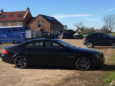

Thanks for the reply’s it does help. I want to go very low hence I want coilovers. I want to go for a really clean, smart look (see pic off google) 24278E30-2D74-46C9-BA2B-8FAAFDF42522.jpeg not chucked on the floor with any old wheels on. nice car the new CLS !

Thanks for the reply’s it does help. I want to go very low hence I want coilovers. I want to go for a really clean, smart look (see pic off google) View attachment 92673 not chucked on the floor with any old wheels on. nice car the new CLS !

What wheels are these?? Looks stunning
