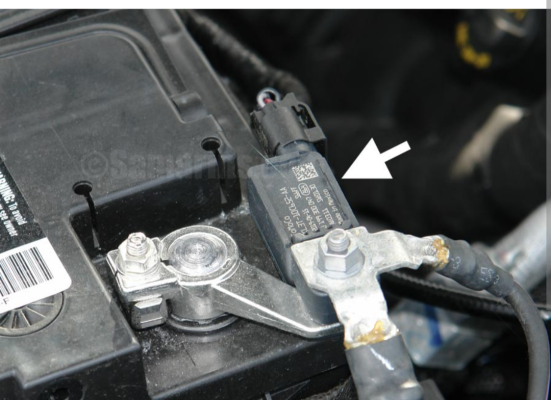

One other thing springs to mind , never charge the battery via the battery posts . The battery monitoring system won't recognize the charge, you can use the live but use an earth from the chassis or something before the earth on the battery. 👍. Hook up the battery charger earth to the BMS before the battery earth .
