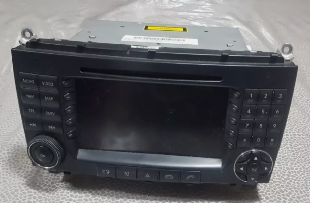

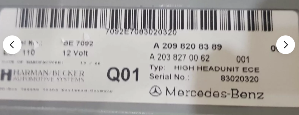

Hello All,
I have the car and head unit as shown above with a 6cd Changer in the glovebox.
I want to replace the head unit with an Android unit, I have found a number of potentials but I need a little clarity before deciding which unit I should buy.
I don't have details of the full audio set up that was installed when new (Is there anywhere I can get this info online or elsewhere ?)
I believe that the CD Unit uses an optical connection.
According to specs for available Android units it seems that if I have external amps (external to the head unit) then I will need an optical convertor.
Can anybody advise whether I may need the optical connector or not, alternatively if anybody can provide a connection diagram ?
I really would appreciate any support that you can provide.
Many thanks
Paul

The guys at www.commandonline.co.uk should be able to advise you buddy
