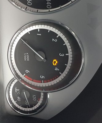

I've got a 2011 W212 E250 with the 7g plus transmission, full Mercedes history so serviced as per schedule etc.
While driving home yesterday I noticed that my engine was revving much higher then usual before upshifting, it was revving to 2.5k or a bit higher before shifting in eco mode, it was like this all the way home, about 40min journey.
Today morning I thought i'd take it on the motorway, everything was fine for the first 10 mins, shifts were back to normal etc, but then it started doing the same thing when I hit about 70mph and now i've also got a yellow/orange check engine light on.
Has anyone ever seen this before? first fault i've had on the car and am a bit concerned, I should have Mobilo, if I call them would I get a free diagnostics? if not tempted just to take it to a indy to plug into STAR, theres no noises, when it does shift its smooth etc.
Advice appreciated :)

A DPF Regen won't cause the EML to illuminate, so I'd say there's a fault somewhere that should be diagnosed.
yellow engine light doesn't point to a serious problem, so I'd say it's still safe to drive.
wait till after 3 drive cycles, it may go off on its own, if not time to plug it in.
Many thanks for the replies, light didn't go so I called Mobilo as per suggestion here, they came out and there were 2 faults:
1) P023714 - the boost pressure sensor has a short circuit to ground - this is what had triggered the EML.
2) "mil off. manifold flap dtcs also present" - it was relating to manifold actuating flap, he said this one may be being caused by the faulty sensor above however so he said first point of call was to replace the sensor.
He replaced the boost pressure sensor, fault light has gone away but it still seems to be holding onto the gears a bit but not as bad as before, e.g. normally it would upshift by 2k rpm, I was at 2.3 and it was still climbing, however only had time for a short drive as he had other jobs waiting, he said the manifold actuating flap fault has not returned anymore so give it a few drive cycles and see if the upshift pattern returns to normal, if not sorting the flaps is expensive apparently, are there any known issues similar to this on the OM651 CDI? :(
Driving home is 35min so will see how that goes.
engine light is back, same symptoms, wonder if I even needed the sensor or a waste of money, time to to take it in I think.
