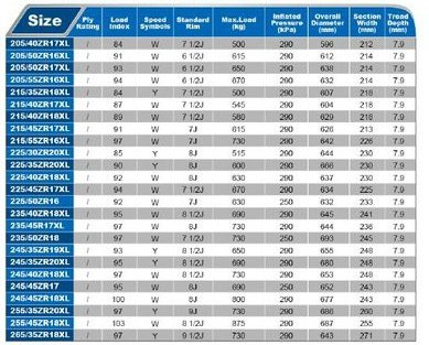

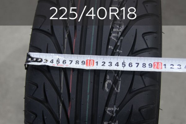

You can't apply maths to tyres pal .
Huge missinformation .

Below is a rare find...
So that's the widths delt with , now for the aspect ratio !
205 55 16 Vs 235 45 17
What's the overall diameter difference in mm ?
So given that tyres are not produced to exact dimensions, how would you advise the OP? Indeed, how would you advise anyone on their tyre sizes?
I am not sure what point you are trying to make, surely not suggesting some sort of industry wide conspiracy?
We can only go by the sizes as on the tyres and in 55 years of motoring it has never given me a problem, and I am sure that I am not alone.
My advice is to keep to the manufacturer recommended sizes .
With one manufacturer 205 55 16 and 235 45 17 are recommended but in the real world are massively different than the math .
