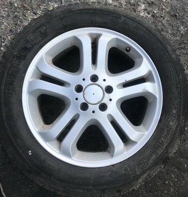

Hi chaps, I'm after a spare wheel for my 12 plate Brabus Vito.
It is fitted, as standard, with 18" wheels with an offset of ET60 (I think!)
As I have no spare wheel, I'm wondering if an ML wheel will fit?
Would anyone know if this type would be suitable please?
Thanks in advance! 👍
From where exactly?
Northside van and truck have one on eBay currently in Doncaster it’s £275 and it’s bare. It says collection but I got a bike rack off them and they transferred it to a closer branch for me.
From where exactly?
If you mean the Vito Sport-X any dealer should be able to supply an original wheel, or Alloywheelsdirect (and probably others) stock them:
However any wheel/tyre with the right rolling radius, offset and hub fitting will work as a spare. Our 120 came from the factory with 17" alloys and a 16" steel spare, which again a dealer should be able to supply if necessary.
