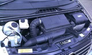

The first image is obviously the engine layout.

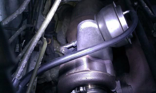

Ok!! thats better... the picture above is the Turbo with the EGR to the rear with the tube and the actuator arm just protruding at the back.

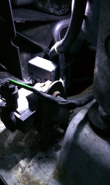

The picture above is the EGR solinoid which the screen wash water was pouring onto.
If this was faulty would it give an error code saying the EGR valve needs replacing?

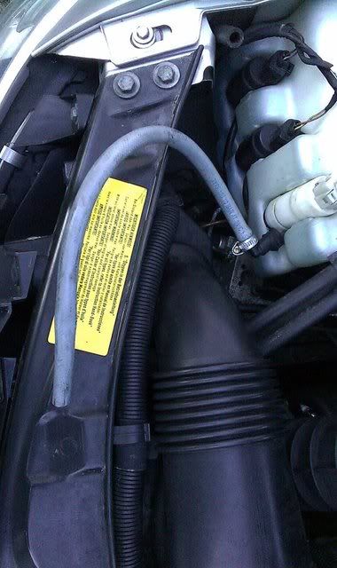

The last one shows the cut off pipe coming from the water bottle (grey)
you can also see the end of the pipe that was originally connected in the top left hand corner.
Hi ya, its hard to tell clearly from the picci but the round thing attatched to the turbo is the watse gate actuator and not the egr valve. Water on any electrical item will cause it to fail eventually so thid could be the answer but now im going to say something that may seem totaly random but the item you call the egr solenoid isnt one of the turbo boost sensors and one of the hoses you have found isnt meant to be connected to this is it??just wondering because anything on the turbo side can cause it to go straight into limp mode when faulty. Just a thought, please dont burn me alive im just trying to help

OK.. PROBLEM SOLVED. Many thanks to those of you who have contributed, or should I say enlightend me in respect of identifing an EGR valve correctly. The truth is I was looking on the internet to get some idea of what an egr valve was and there were a few dud pictures which put me right off the track, anyway I got the local MB dealer to email me a diagram and with the help of you guys I managed to find the egr, whip it out clean all the crud off re-fit and HEY-PRESTO all working fine.. at last, going like stink.

I guess, when you turn the ignition on, a series of automatic checks are carried out prior to the vehicle being ready to start, and the egr, because it was stuck in the shut position, sent a fault signal to the ECU triggering limp mode. As soon as I cleaned the gunk off the valve it could move freely, therefore sending an 'all clear' signal to the ecu. I hav'nt got a clue why your's can't register it's dissconnected.

Someone said already but that is the wastegate actuator not the EGR, which is probably why it looks different. Phone mb dealer they will tell you the correct part number for you vehicle
