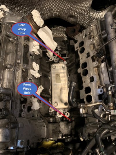

Wondering where did you get your nickname from ;D how many percent you put on "elsewhere".... Om642 has two weep holes, first at the front... coming out near/above starter motor. Second at the back, heading into bell housing and on the floor. But 100% is bit over confident, what if coolant was coming from thermostat dripping all way down reaching,like you said weep hole. Would you strip everything all way to the cooler?
I think you misinterpreted what I meant. A leak from the weep hole is coming from the valley. The thermostat will drop coolant into the valley, so it’s on that list. Heater hose for example isn’t going to come out of the weep hole. There’s coolant in the turbo pedestal too, another possibility and weep hole there too.
The rear weep hole is the one near the starter motor. The way the engine is slightly inclined in the car any fluid always shows at the rear one first in my experience. Leak needs to be pretty bad to be showing at both.

Of I didn't have one, my local "cowboys" would take gearbox off only to find out that oil wasn't leaking from crankshaft seal. £1000 badly invested.
On another note, I wonder if one of holes got blocked with debris and leak isn't that bad. Chance why it disappeared and then appeared at the front.
