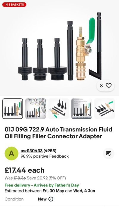

For any transmission stuff I stick with MB. Not that the parts warranty is any use to you in the event of a problem. I had a thermostat fail and they wanted the car in to diagnose it with a big bill coming my way. If they had fitted it that is another matter.
Go in the dealer and haggle. £160 is too expensive. That’s a 5L can of fluid.
