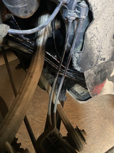

A little prevention, hopefully.

Having a clean bill of health, for my rear subframe from Mercedes Taunton a few weeks ago, I decided to try and do a bit of preventative work, I cleaned up the ends and insides of the frame, sprayed a load of paint in there, then cavity wax, then I made a wheel arch liner extension piece, out of strong clear film to cover the open ends, hopefully it will stop it getting filled with road grime.
