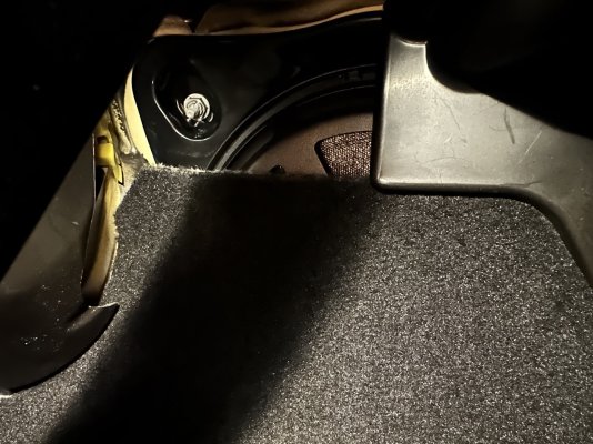

I was gong to leave it at that, until I looked closely and realised that in the Premium e class (non-Burmester), there is only one bass speaker in the passenger footwell. I had looked in the driver footwell and had seen a black plastic thing screwed to the body and thought that must be a speaker as well - on closer inspection, that's just a plug, to cover up the speaker hole.

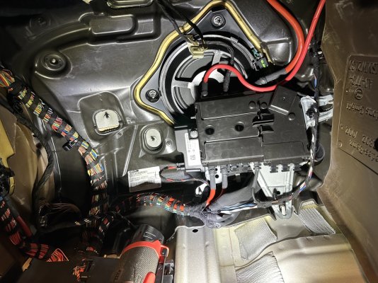

Carpet removed from passenger side (loosen the seat so you can yank the carpet out) there's a ton of wiring in the channels.

With the plastic cover removed, the standard bass speaker is revealed. Behind the power block.

A comparison of the standard 6" speaker with the Vibe Audio unit. I swapped the basket from the back of the factor speaker onto the Vibe one as there were clips for it to fit to.

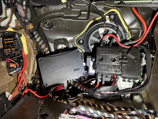

With the Vibe Audio speaker installed, there is just enough room for the amp - I wired this to the adjacent power block where there is a spare terminal. I positioned my switch up in the fusebox, so I can just pop off the plastic cover and switch off the amp, should that ever be necessary.

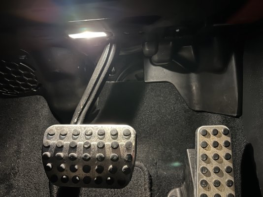

Once I got everything back together and the amp configured with my laptop, I rather lost the will to take pictures so here is one of the driver side bass speaker once installed:
It's just peeking out where the plug used to be. Obviously there was no cage on the plug, so I wasn't able to install that on the driver side bass speaker. but I haven't noticed much difference without it being on there. With the lower dash cover removed, there is enough room to pull the carpet down and out of the way to install the speaker. Having a powered wrench certainly helps with the bolts.IMG_8016 Large.jpeg
