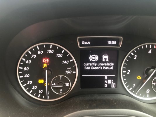

Came back from holiday in the Lake District and 20 miles from home EML came on and display says "ABS fault", "runflat indicator inoperative" plus other faults even "reverse not available".
Everything pointed to ABS wheel sensor failing, the car was left for a few minutes then restarted and worked fine, few miles down the road the fault returned, this carried on several times and has done so since.

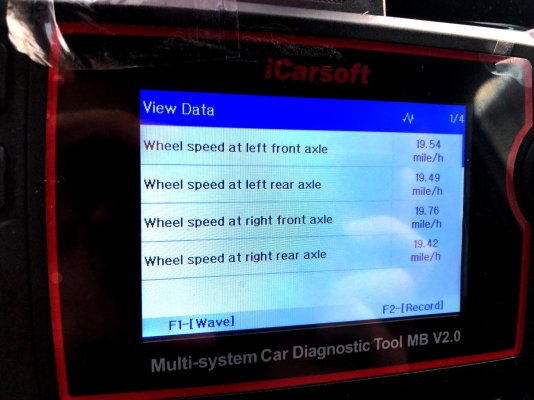

So I put the Icarsoft on and reset all the codes, then monitored the wheel speeds on a short run, its fine until I get to around 25mph and the fault re-appears.
Below this speed it drives OK, soon as I go faster the EML light is on and all the faults return.

Why when I then reduce speed the Icarsoft still shows no road speed for the Left front wheel ?
After codes are reset the left wheel shows its now turning again until it reaches 25mph, does the ECU turn the speed monitor off ?
Looking at a series of photos taken on a short drive, it seems the left front wheel spreed drops off while the other wheels increase.
I wonder if the ABS will not operate until the car reaches 25mph and at that point it sees a imbalance in wheel speeds and shuts down.

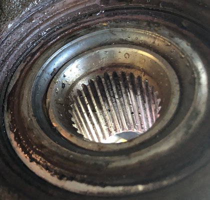

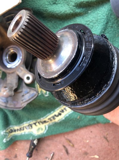

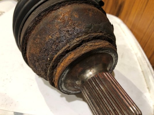

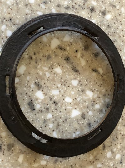

Took the wheel hub off and found the what I think is the abs sensor plate, it has a crack and the cv joint it fixes to is all badly corroded. I will get a cv repair kit and order a new sensor plate. The outer cv is so badly corroded the sensor plate is loose. 8A049248-DF32-4A7A-9150-5DCA9FE4E75E.jpeg1F695BF2-B39E-478C-9BDF-887C04D20FBB.jpeg
Finally solved my ABS problem so if anyone has similar issues, this is what I found.
The wheel bearing has a magnetic encoded seal, this replaces the traditional reluctor ring that's fitted to drive shafts.

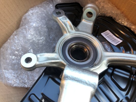

When I took the front knuckle off I could see the bearing seal was damaged, I did think about just replacing the bearing for around £40 plus getting it fitted with a press, but as its been off the road for around a week I phoned Mercedes Edinburgh and they sent a complete Knuckle for £240, including next day delivery.
Took about 1 Hour to fit, took it for a test drive and its fixed, success.
The left hand drive shaft was very rusty, so may have caused the damage to the seal, I have cleaned all the rust off this and painted it. It was also fitted with a new centrifugal seperator.
All the codes were cleared and not it runs as new again, so the wife has got her car back, she is pleased although she did tell me to take it to a garage to fix it after 5 days of getting nowhere.
