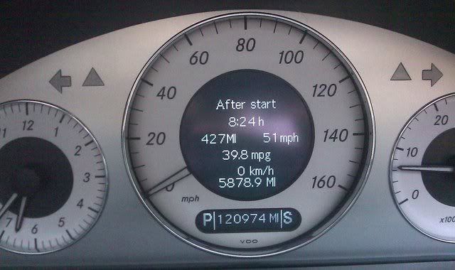

This was my E320 W211 today.
Mixture of decent speed motorway together with traffic jams....

I'm pretty confident that into the 40's is possible after my day yesterday. 39.8 was not achieved by driving economically.
