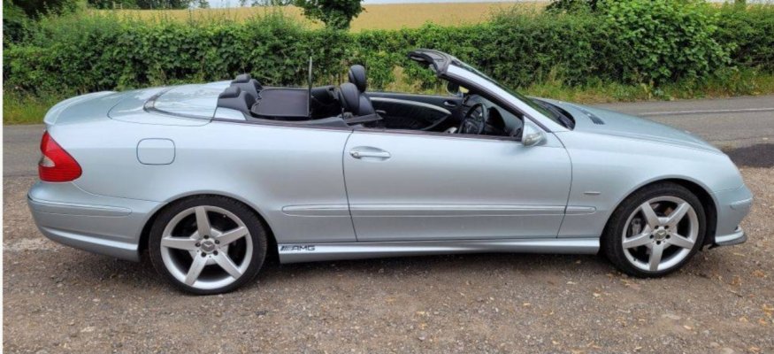

I have a slightly weird situation with my air-con. It was getting really chilly on the passenger (right hand drive, UK spec) but only tepid on the driver's side.
Reasons posted for this common complaint are many and varied, some say low refrigerant means it only cools one side of the car, others say that the stepper motors that control the flaps get out of alignment.
Now I've been able to do a partial fix.
My model is a 2005 CLK350 SPORT.
To realign the flaps you press the FRONT window demist and the recirculation buttons together for about 4 seconds. The amber and red lights on the buttons then flash alternately for about another 5 seconds before going out, and the heater flaps/motors reset. Apparently this is something that should be done at every service.
The result is that now the air on the driver's side does get chilly, albeit it takes a little longer to chill right down.
This was visibly discernable when I put the heater (with aircon on) onto a cold windscreen. Initially it misted up (warm moist air hitting cold glass) then after a few seconds the passenger half cleared. It took about 45 seconds for the driver's side to catch up, and dry the air.
I'm currently waiting for a "formula one autocentre" to check and re-gas the system.
The system very recently had all the gaskets replaced (with genuine Mercedes supplied "O"-rings), a pipe to the compressor replaced, and a new condensor with filter/drier.
It was re-gassed, but they didn't have a machine to bring about the sufficient negative air pressure needed before adding the refrigerant (-2 bar), and so although it undoubtedly worked, it wasn't quite right.
If this re-gas and pressure test works I'll let you know, with the added information that either it's true, low levels do result in it getting colder on one side than the other, or no, that's just another myth causing misdirection.
Well, I have to say it's "ice cold" all over now, right where you want it.
Lovely 🥶
However, within literally a couple of miles of thinking "Finally, everything is working as it should, no more unscheduled expenses now except fuel and shampoo" when a BMW M3 had to overtake fast and cut in (trying too hard to be faster than an AMG) and CRACK!!
Non repairable stone chip.
Booked in for a new screen via my insurance, on Dec 29th. They promise like-for-like, it had better be, I'm getting hacked off with having to correct mistakes made by garages.
The impact dent itself is about the size of a 5p, but the spread of the cracks is the width of a 20p piece.
I bought the car in August, it then spent 2½ months in 3 workshops (the second one had to fix dangerous issues caused by the first one), I've driven the car maybe 12 times in total, and having spent £4k on replacing everything from the water pump, rad, air-con components, coolant pipes, brake calipers, brake hoses, tyres, gearbox oil/filters/pan, differential lubricant, new underseal, and air pump for the pneumatic seat pillows. And interior seat trim, oh and parking sensors and polishing the headlamp covers.
Now it's going to be treated to a new windscreen.
It's Trigger's Broom reincarnated.
But faster.
