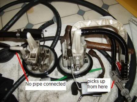

These are the senders and tank diagram.

Do you have those fittings shown in the above diagram as that looks like the layout for the C250Cdi?
Does the fuel feed not come out of the bottom of one of the senders (nr side tank)?
Post some pics of the tank and parts if you can.
