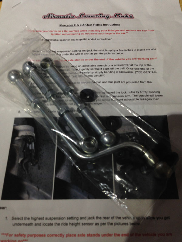

I have for sale a set of AirMatic lowing links for E Class (211) and CLS (219) which I bought with the intention of fitting to my car but I have now decided to go the Renntech ELM route. Supplied with fitting instructions
£60 including postage
Are these lowering links for both front and rear Mick? I can only see 2 struts in your pic.
Also, by how much do these links lower the car beyond the lowest setting we have now?
Yes these are for both front an rear, 2 links for the front and 1 for the back
According to instructions it says:
Front: for every 3mm longer you make the links it will lower car by 1/2"-3/4" and not to exceed 8mm longer than stock
Back: for every 3mm shorter you make the links it will lower car by 1/2"-3/4" and not to exceed 8mm shorter than stock
