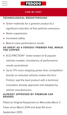

For C Class 2014 onwards OEM is Ferodo Eco Friction .
