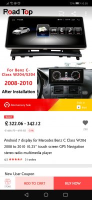

I just got my car from the garage and had mentioned about the android screens and the mechanic said he fit one recently and and said it was really good, but fast and smooth when I asked where his customer sourced it from I was pretty shocked when he said Ali express !? ?! I I'd always put that website down to cheap knockoffs and items not being sent out??
Screenshot attached
Anyone else tried or ordered one of these by any chance and what experience dif you have if so

That can depend on the age of the car really. In the older models the Android head unit is a complete replacement of the Mercedes system. With the later cars, if you get the right one then it is an overlay on top of the Mercedes system and you still get all of the OEM systems as a picture in picture way on the HU. Even some of the newer ones have some very poor implementation of the interface combining the two, in particular the smaller units. The interface in the image is one of the decent ones, you just have to make sure it is the V2 version with the Mph and centigrade capabilities. The V1 did not have this, just Kph and lots of spelling mistakes.
Car-life appears to be one of the Chinese resellers that people have used successfully.

As this is a C Class I assume, you may want to go and look on the forums at MBWorld as there has been mixed success across the C class range due to it not have an Aux input setup in the same way as the E class on some. People have had to bluetooth connect and not been happy with the lag in the process when watching video content as the lip sync has been out.

OK, just the image you linked to was for the C class. Each has a different mounting plate which is unique to the car so you need to make sure you get the right one.

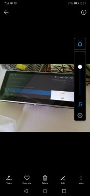

OK I've spoke to the dealer and he reckons the below one is best for my car and said latest version showing the attached picture
US $519.21 27% OFF|Aliexpress.com : Buy 10.25" Android 7.1 Car Radio Bluetooth GPS Navigation Head Unit Screen for Mercedes Benz 2009 2015 E300 E350 E400 E500 E200 E250 from Reliable Car Multimedia Player suppliers on Road Top Factory Store
£424 for right hand drive
Am I missing anything? I and do I have to order a mercedes specific camera or can I rig any cheap one from ebay to it ?
Any other input or recommendations would be appreciated.

400 quid for that, i nearly fall off my chair :D
My friend recently bought one from hong kong for his Alphard and it's around £100, you can buy a flight ticket with the difference and go buy it yourself :D

I know lol. Saw at 340 originally on aloexpress (most places charge 550 plus) and thought I'd stretch to that seeing as it's a bit better looking option over a lower double din dash for 250 etc but typically for my car and right hand drive it's shot up.
Thing is Ive had stereos for under 200 quid before and they're no upto much am hoping this feels a little more flush / stock like it originally came with the car over a double din which I've seen and feel they cheapify it a little being a merc.
Guess will see once 400ixl confirms and I've had chance to fit it
400ixl do you reckon it's worth upgrading the above to the octa core one ?
