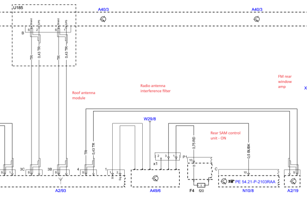

I swapped the Comand 2.5 for a (actually really good) cheap Aliexpress Android head unit. Everything is working except FM reception. I've traced this to what I believe is an output (actuator) on the rear SAM that looks like it powers 'off' the antenna via what is loosely described as 'antenna filter'. I think its a power switch as well as filter.
So, are SAM outputs open drain or open collector? Or do they mix them?! A temporary fix will be to apply 0V or 12V to the 'filter' pin3 I think, or can I be more correct and force a SAM output using some kind of CANBUS tool? GPS is working perfectly, but I'm not sure how that part (also in the roof) is powered.

Hi, thanks for the rapid reply! I checked the antenna power on the auxilliary head unit connector in the car and it doesn't exist. I only have 2 twisted pairs for the dual mics in my car instead. This is not the standard Comand 2.5 pinouts you see on the web, but is in WIS for the R class.
I'm using the head unit to power a twin FAKRA adaptor as I thought the FM amp got it's power through the co-ax. That isn't the case. But yes the head unit ant and amp aux power outputs do give 12V as expected when switched on, on the head unit side. I am fairly sure there is not a conventional head unit power on on the car side and it is sent via CAN to the rear SAM. N10/8 connector C 10 turns the amp on.

Yes, both powered and checked with multimeter. I am fairly convinced the rear SAM turns the FM amp off though.
Is there a canbus connection to the FM amp?
While it's possible that it is SAM controlled I don't see a logical reason to that design.

I have one of those and 12V measured on both centre pins. See pic below.
??? Why has the SAM got a connection (transistor shown) to the 'FM filter' (also shown with transistor) unless it is a switch? ???
The ML (and I assume the R class) can switch between rear window antenna and roof antenna pack, could be that, and equally could be wrong (i.e for the pre-facelift car that had separate power feed to turn on antenna amps). My memory is that the roof antenna pack does the actual switching, but I can't recall what tells it to switch.
