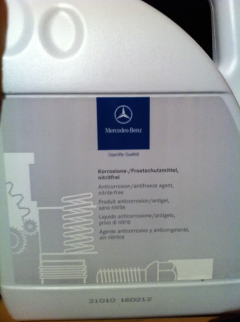

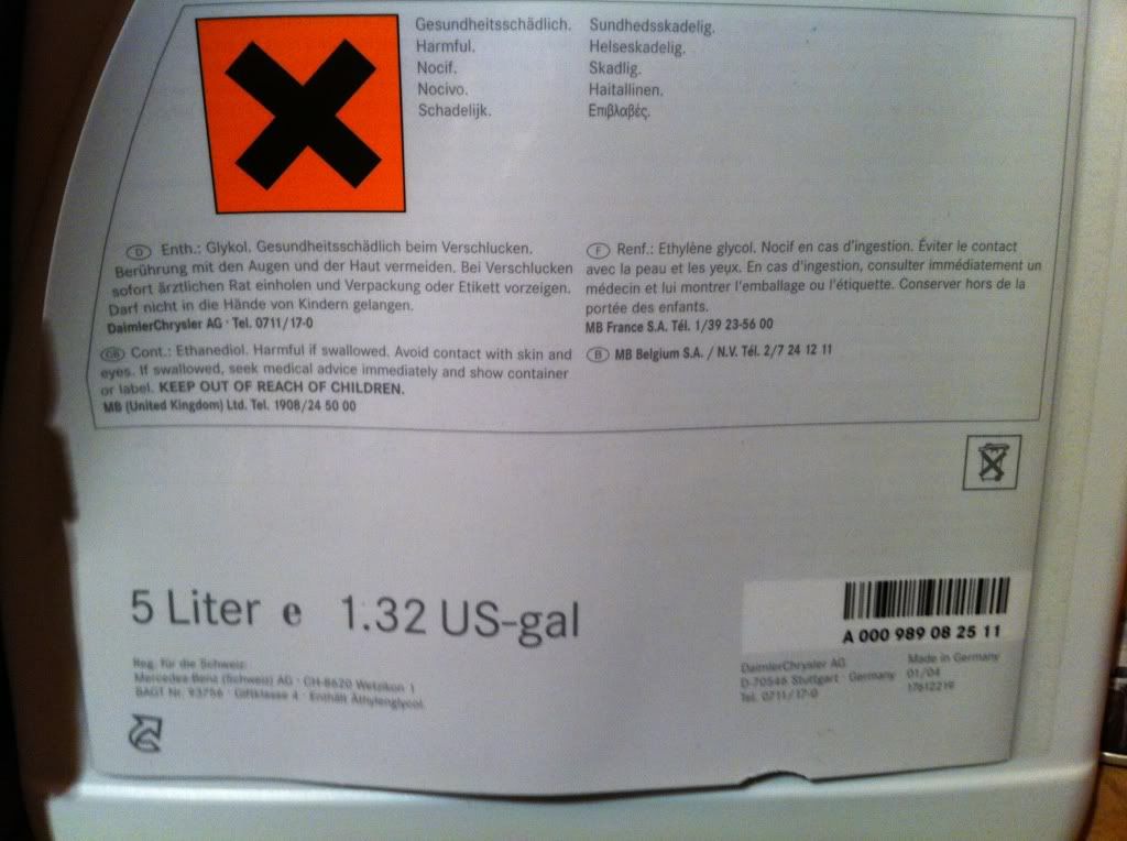

Just changed coolant. I have bought it from MB dealer. Dealer saying that they use only one type of antifreeze in all of their vehicles. The colour of that one is green, so I don't really understand where red, orange, amber or even blue came from? As I have seen in many post on forum UK & US.. Or dealer is cheating?
The point is...the colour does not matter.
It depends what year/generation vehicle you got.
Early cars before approx 2001 were short life coolant, and after that date (approx. as it was a phased-in programme) used the long life coolant.
The latter had a releasing device in the coolant bottle.
So VIN needs to be given to parts person, as engines and associated parts were engineered for the long life coolant.
I agree that colour is not matter, but if MB use only One type of coolant as I have been told by them, why I am getting green and other person blue especially in the same country (UK)?
The man from part dep. didn't won't the VIN not even no. plate. Basically he didn't want to know what model is it, cos they use ONLY one type of coolant in all of their cars! This are his words.. Hmm..
