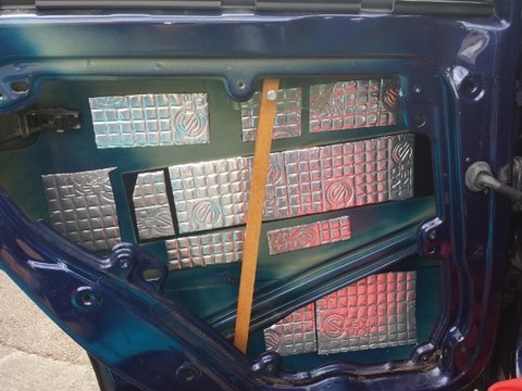

As part of the audio system upgrade, Comand UK fitted Dynamat sheets to the inside of the doors.
It could be fitted in other areas as well, e.g. under the bonnet (ensure correct material - heat-resistant etc).

Yes used lots of Silentmat in the doors, also took the wheel arches out and did behind. The biggest impact was putting some sound insulation sheet over an around the plastic spare wheel tray.

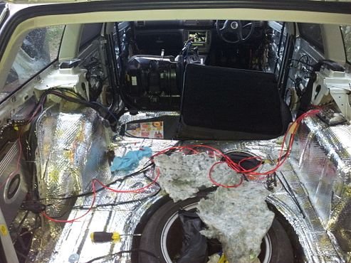

I completely stripped out the interior of my sons A class and used Dynamat on every surface I could get to. Entire floorpan, side panels, doors skins, wheel arches, boot area. Its as quiet as an S class now. If I could have got the roof lining out without destroying it Id have done the roof also.
You don't need to blanket cover , just tap out with a knuckle !
It adds so much weight .
Tap out the most resonating parts and apply.
