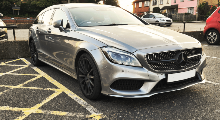

OK thanks but finally found it - no thanks to my local dealer - who apart from saying it was in the boot were unwilling to offer any more help even though I bought it from them - their advice of course
was that I should bring it ion for a Mercedes specialist to fit.
It is actually a doddle to fit but finding it is not obvious ... for anyone else looking to fit one to a CLS X218 estate ... it's at the bottom of the boot well right at the very back on the driver side - you need to remove the felt cover (just yank it out) and then you will see the battery - even if you remove the fely cover and peel it back it's still easy not to see a battery anywhere if you don't know where to look!- I looked several times and even removed small front boot flap but couldn't see it anywhere - if only my garage had just told me where it was I could have saved a whole load of time - not sure I'll be buying my next car from them!

it was a Fiammm - all fitted and working now and issues solved I think/hope
