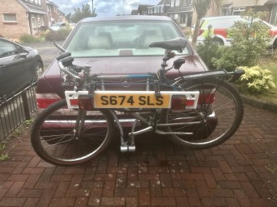

This is the Thule carrier I have for my bike and my son’s , it folds up and takes little space inside the boot when not in use - you can get a three bike version , and some of them fold out of the way to open the boot , even with bikes fitted . Note how much my adult bike sticks out each side of the car , and I suspect my W140 will be wider than an S213

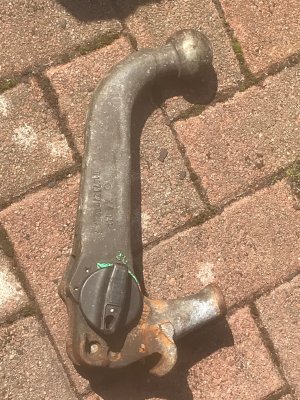

Here is an Oris detachable tow ball , from a W124 bracket I have out in the garage . The hook on arrangement varies from one model to another . I bought this for my SL but never got round to fitting it ...
With this part unhooked , you wouldn’t know the car had a tow bar .
