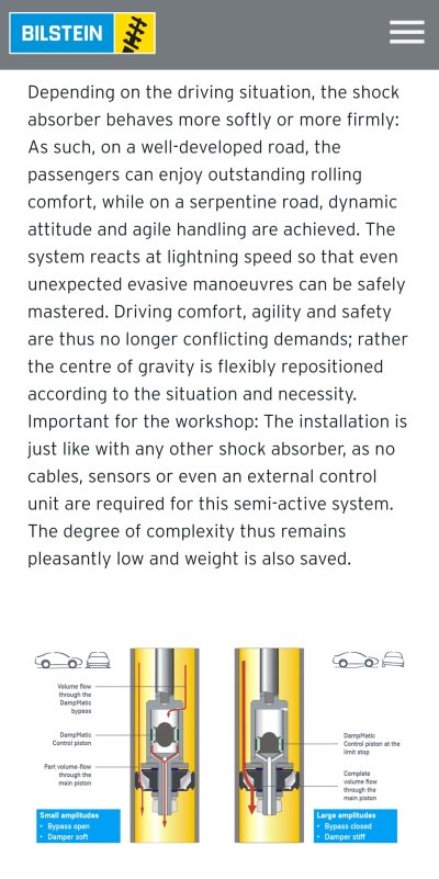

The Mercedes OEM damper for this S204 is made by Bilstein , so buy Bilstein and it's not an ordinary Bilstein B4 either, but a B4 DampMatic®
No B6 or B8 needed .
Is it B4 shocks with sports suspension though? Mine has the option 486 sports suspension. B6 or B8 may not necessarily be needed but a worthwhile upgrade surely?
These B4 DampMatic® are a dual rate damper so you get the best of both worlds on Britain's broken roads.
With B6 or B8 you will just compromise comfort .
I've ordinary Billy B4 on another but older car and the ride is firmer than DampMatic , all B4 are slightly uprated anyway hense being described as having high power reserves .
