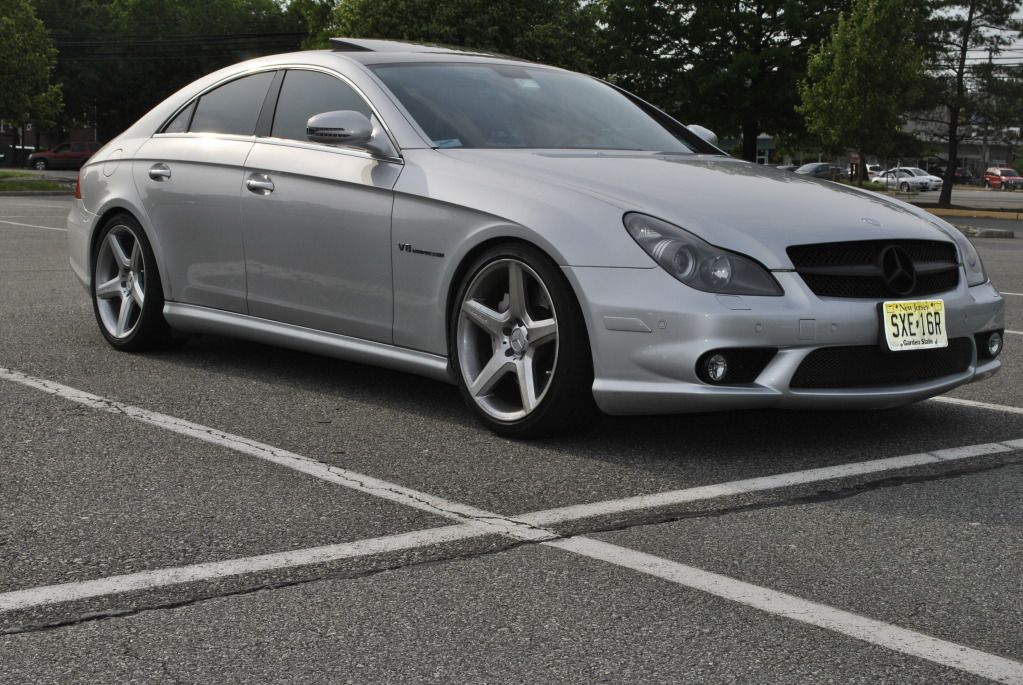

I have seen some pictures of CLS's with black headlight housings, I think it looks amazing.
Has anyone done it, can anyone do it for me? Is it easy?
it can be definitely done, think it requires the front bumper to come off then you can remove the headlights. on the US site people bake the headlights in the oven to loosen up the glue holding the lenses on and then prise them off. The internal reflector can then be painted and just resealed with silicone. I just dont think I would be brave enough to put them in the oven
