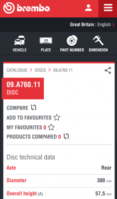

Have you the Sport package 295 mm front and 300mm rear ?
If its the AMG sport pack they'll be 295mm front - drilled/ventilated or ventilated any will do. The rears are smaller at 278mm
295mm sounds right for the front. Not sure about the rear but some website list 344mm brakes??? I know that's not right

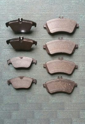

Reason I ask OP what size is I have some used pads that are surplus .
9mm left on the fronts , 10mm on rear.
