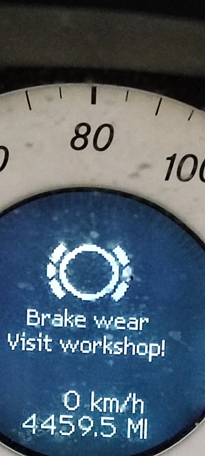

This brake warning light below, is it always related to pads and discs or can it be brake fluid as well? Front pads are booked in for replacement but wondered if brake fluid may need changing.

The wear indicator can only monotor the brake pads.
The disc thickness needs to be measured and they need replacing on average every other pad change. The minimum disc thickness is stamped in to the disc surface.

Break warning designed to come up when the pad has 4 mm left. (After apx 80% use)
