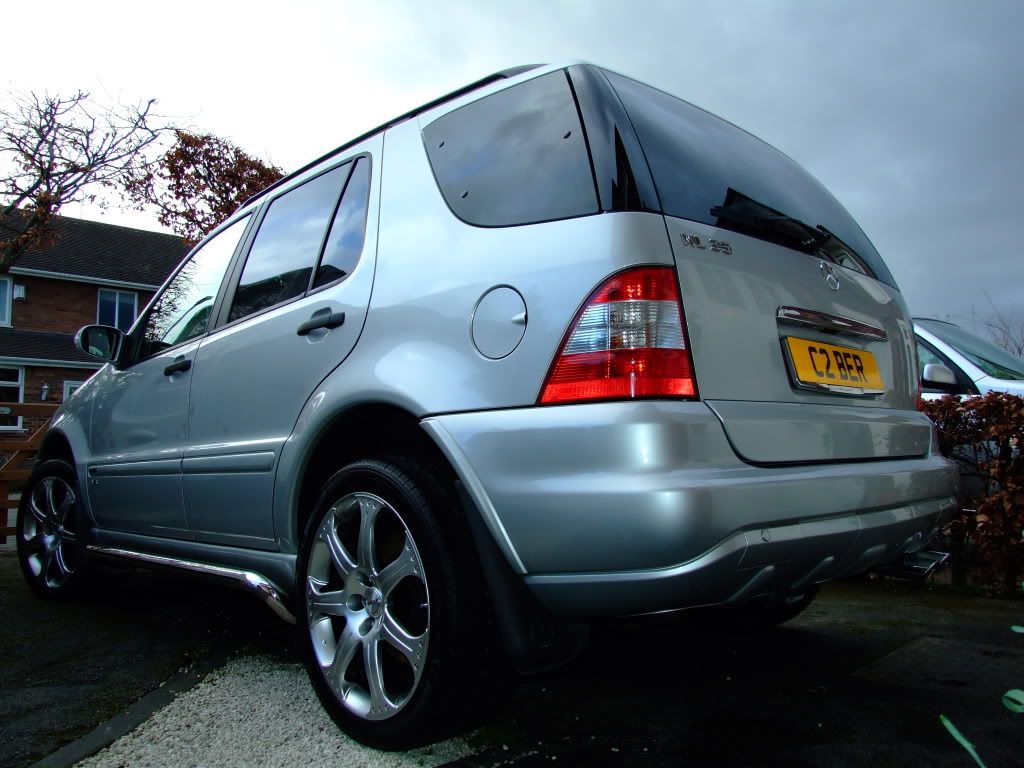

I've fitted this kit below (came pre painted for £30 off a famous auction site)...
Think from memory it was 4 bolts holding the bumper on and all I did was slide it off enough to get behind it. I also chose to fit them in the blanking plates where the spare wheel carier would be fitted. I didn't fancy drilling the bumper if I got it wrong and this covers were something like £20 a pair if I messed up :)
In the end it looks imho pretty good, works a treat. Even though there is only two its as good as factory fitted cars I have had with 4 etc.
They have been on now for almost two years and have only failed once in that it was around -6 and the ice had frozen over them, after 30mins or so they were fine again :)
