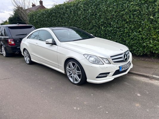

No it’s a UK car with VOSA verified mileage from its first MOT in 2015.
I just viewed it and fell in love with it, just drop dead gorgeous shape on these and yes it’s 19” wheels having been refurbed last year by the lady owner and are still unmarked.
The 4 tyres had good tread on them, this will be my first time to own a car with a staggered wheel set up, and more importantly it’ll be my first RWD car too… I’m quite excited by it all!

Here’s a photo I grabbed from today.
If it has Start/Stop, then it will likely have the 7G Tronic+ transmission - the service interval is every 5 years or 77,500 miles, whichever comes first.
A 2012 car should have had the transmission serviced in 2017 and then again in 2022, the next service will be due in 2027.

The 350 petrol has an M272 engine, and in one of these will have been manufactured long after the M272 engine balancer chain issue. Decent 19" front tyres (Goodyear F1 Eagles) are about £150 upwards each.
