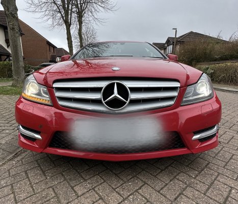

Around 2 weeks ago my side light “the C shaped light” stopped working. I realised that my auto full beam isn’t working when the stalk is in the forward position and the lights are in auto. But I am still able to pull the stalk backwards to flash full beam. And when the lights are not in auto the full beam works with the stalk in the forward position. The indicator in that head light (passenger side) also doesn’t work. All other indicators lights work fine (wing mirrors rear and the drivers side headlight).

Is the light that's not working the DRL?
If so, it happened to my w205 and Mercedes said it needed a new controller, not the headlight itself. Came to just over £200.
Hi rf065,
So I don’t think it is the Day time running lights. On the picture I’m sure the DRL are the very bottom of the bumper.
The light that’s not working on mine it the C shape light (in the passenger side headlight). I tried to get on the lights on while taking the picture.
You can see the driver side indicator is on and the C shape side light on the inside of the headlight assembly is on.
