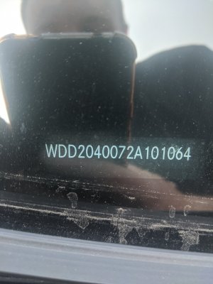

Iam not sure what or where it is but is a 2008 c200 sport CDI 2.1
Sorry I've not got it to hand Iam not at home Iam at the misses house
