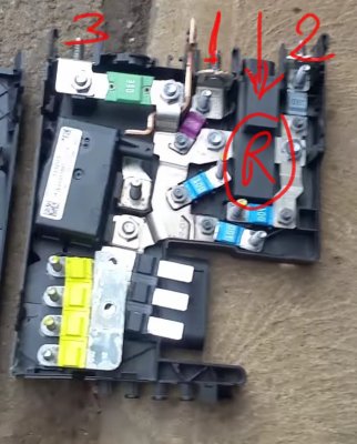

JulianB Can you tell me what exactly had you short-circuited on prefuse box F32 ? I have a picture as exemple.
Sorry Dkbkl, The RAC/mercedes emergency support mad did it but I think as I said it was the very front one and the positive terminal that you use to jump start. my guess is that thats 1 and 3 on your diagram.
