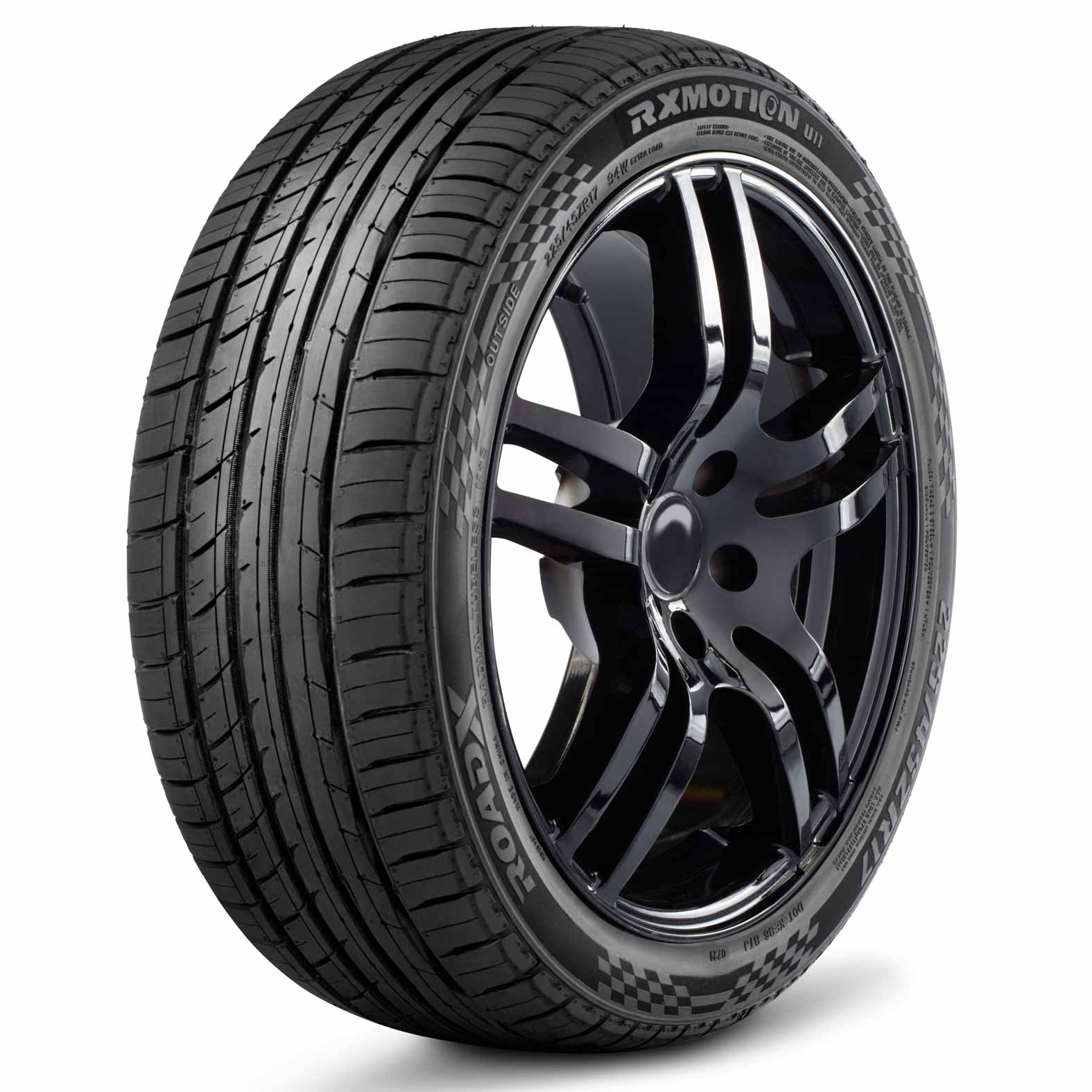

Bonnet open. Stationary. Engine on. No excessive movement in engine. Don’t think it is motor mounts. Took it for alignment but everything fine. Wheels were balanced on the day of purchase. I was watching that and don’t think the wheels are suspect. New Road-X tyres on all 4 corners.

Look at the reviews for Road X tyres.....might be your issue.
Fair enough. I want run on flats anyway so they will be on flee-bay soon. Hopefully, arrive in the next week or so and will take it from there.
Interesting reading.
The tyres improved things a great deal. However, my tyre guy (known him for years so just does swaps for beer tokens) noticed a lot of play in the o/s/f wheel. He suspects a worn ball joint. Thinks that might be behind the vibration. Today on a low speed sharp turn in a tight underground car park, I heard a clunk. I was able to recreate it a few times. Whilst I am down there.. I will check tie rods, control arms etc. See what the trader says. Seems premature for that kind of damage but no telling what kind of life the car had before even if MOT history was clean. Will hopefully return soon with an update.

What happened to the new tyres ?
Swapped back and put them on wife’s E class. They can have their Road X rubbish back. Now chasing a low speed pop noise on the E class. Cars been doing my head lately.
