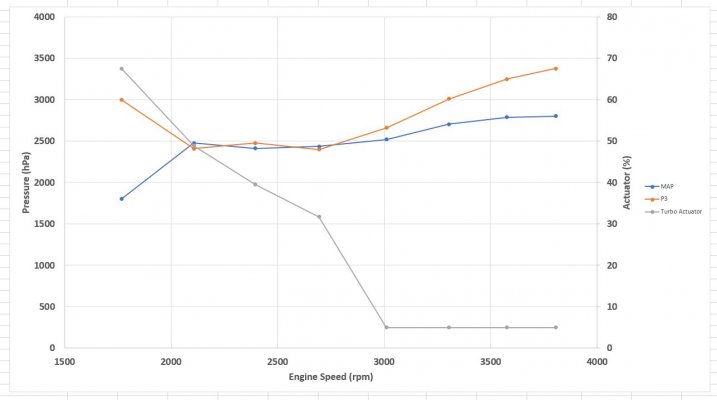

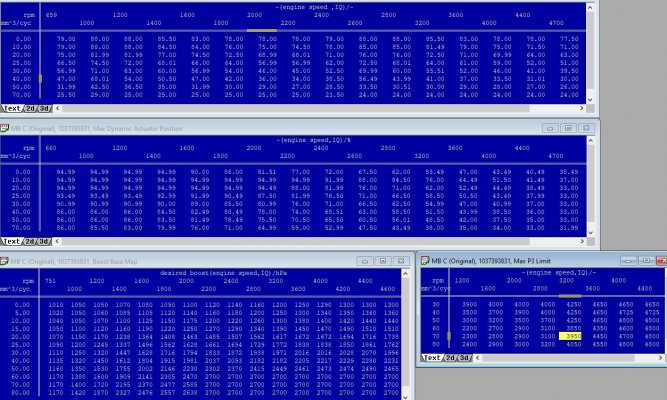

Secondly, I cannot get it to boost, I have tried changing base map, atmospheric protection map, various actuator maps and none of them make a difference. The engine looses boost in the midrange, but the actuator position is nowhere near any of the actuator maps.
Base actuator, dynamic actuator, P3 limit, Base MAP :
The more I think about I think I have missed torque limiters somewhere?
