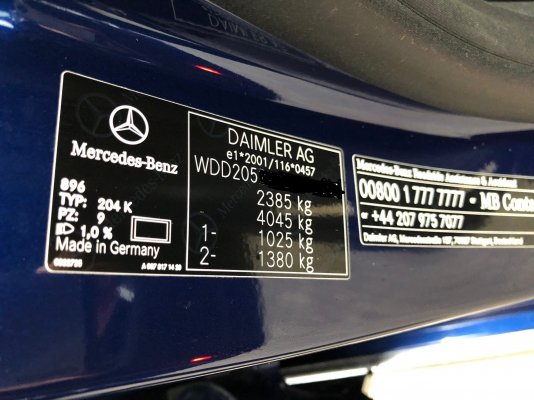

I've just looked at my plate, and I think this suggests mine can tow.
Is anyone able to confirm that's what it means please?
Yep, that second figure is the ‘train weight’ - loaded trailer plus tow vehicle. 1st is Gross Vehicle Weight, so max towable is 2nd - 1st = 1660kg
(just put a kit through IVA so those numbers are burned into me given I got them wrong and it failed!)
Agree with Chris-S re tow limit. Make sure you know what the dingy and trailer combined weights, as it must be less than 1660kg
Tow bar fitter can code your MB, and they are about 50% of the price of the main dealer. Personally I use the main dealer for all software related changes, but that may be me being over cautious
