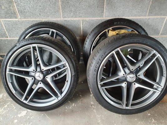

I went with 1 size wider on the rear with my new wheels ie 275,35,19 MPS4S
Fronts are Mo1 also
Hi , what size tyre is shown on the fuel filler cap ?
Just looked and just gives pressures not sizes.
