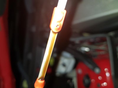

    I got this message today on the dash, was worried for a second as any oil warning lights always scare me. Anyway, stopped and checked, bit confusing as the dipstick has 3 red tabs, it's sitting at the top of the second one.
    How much should i top up? And is this the correct oil?
    Mobil 1 Fully Synthetic 0W40 Engine Oil 1L
    Cheers

    Top of the second, as in the top most level? You’ve too much in there surely, needs to be about in the middle between the markers
    Where the blue marker is a nice spot (not my pic)
    Between the two red markers is exactly 1 litre

    The middle red tab (attached a pic) so i need to top about 1 litre?
    Is the Mobil 1 i linked the right oil?

    It's important to check the oil level under the correct conditions. The Owners Manual tells you how, but briefly it's:
    • Car on level ground
    • Engine at normal operating temperature
    • Switch off engine and wait 5 minutes
    • Check oil level and top up as required
    You need an oil certified to MB standard 229.5 (not 229.51 which is the low-sulphur version for diesels with a DPF). The Mobil 1 product you linked to will be fine.
    The manual will confirm the quantity of oil between the different dipstick marks. If you are uncertain, add 0.25 litre, wait 60 secs and check again on the dipstick.

    Cheers bud, iv always checked oil after the car has been standing over night as all the oil is drained down into the sump?
    Il give it a go like the above later today, iv got the oil!

    This is not an issue, as long as you keep in mind that the oil will expand when hot.
    So if it's well under the max mark when cold, or if it's just under the max mark when hot, then in either case it's fine.
    The important thing is to ensure the oil level does not rise above the max mark when the oil is hot.

    Iv added about 250ml and still no change on the dipstick, waited 10 min and it's still showing exactly the same as before. I can't find the manual, does anyone know how much oil between the middle and top red tabs? Or when you get the message. I don't want to overfill it
