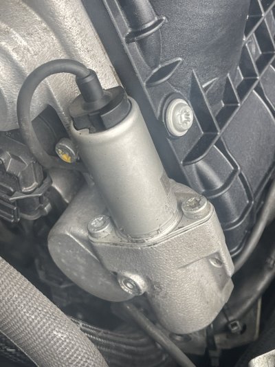

I hope someone could offer a little advice, I’ve recently replaced the passenger side (uk) cam cover due to a hairline crack at the back.
I was careful with the wire harness that runs round and didn’t touch anything else, the job was relatively smooth.
Along side that I changed the oil to 5w-40 with ceratec, upon starting the car I now have a solid EML.
Scanning returned:
P0020 - Powertrain - "A* Camshaft Position Actuator Circuit (Bank 2)
P2285 - Powertran - Injector Control Pressure Sensor Circuit Low
I checked the oil level, which looked ok, took it for a drive and there doesn’t seem to be loss of power or any obvious running issues so I cleared the code which stayed off for a 2 mile run. I stopped and restarted which brought the EML back with a slightly different second code:
P0283 - Powertrain - Cylinder 8 Injector Circuit High
I’m unsure on what to check next, does anyone have any experience with this? - I have checked countless forum posts and videos but there’s so many intermittent solutions, I’d prefer advice from you guys who would likely know more on this issue.
