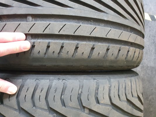

My E350 C207 has just had it's front tyres (Uniroyal Rain Sport 3s) replaced after having done 35k on them. Whilst I cannot complain about the time they've lasted I too had serious inner edge wear.
Hunter alignment was done when tyres were new and once more since then.
