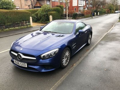

I have just bought a 2016 SL400 which was coated at the MB dealership when new. There is one small 1 inch scratch on an otherwise immaculate body. Can this be repaired (easily or otherwise) ? Thanks for your help and experience.

The car still gleams and water beading is very good:-

Probably depends on how good the coating is in the first place, but yeah aftercare plays an important part.
My own car is to get an inspection every year as its got warranty for 7 years - gtechniq crystal serum ultra.
But a ceramic coating isn't all that hydrophobic, it need something on top of it to help with beading, in my case gtechniq exo V4 was applied on top of the coating.
The company that applied mine said all I need to do is apply gtechniq citrus snow foam every 6 months really, or if I notice the beading dropping off.
