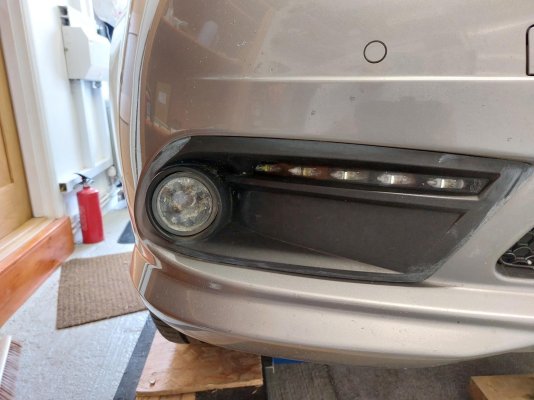

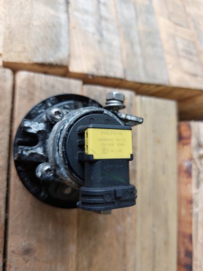

I posted elsewhere in another thread that I had an issue getting the bulb out of the left fog light in my 2009 C 250 CGI BlueEFFICIENCY. Today I have removed the screen wash reservoir to gain access to attack the issue and eventually managed to remove the fog light from its housing in the front bumper/spoiler. It really needs to be replaces along with the drivers side which has even worse reflector corrosion and its own blown bulb). The problem I have is that despite the Mercedes Data Card confirming the car should be fitted with "772 AMG STYLING PACKAGE-FRONT SPOILER, SIDE SKIRT" and Mercedes EPC telling me that for my VIN number I need part A2048202156 it just isn't the right one! Mine is a much smaller diameter, has different fixing and takes an H8 33W bulb and not an H7 55W. I am therefore concluding that a previous owner has changed this in this department. I am really wondering if I have a couple of aftermarket units fitted as not only is there no MB markings on my unit I simply haven't seen anything that looks like mine which pushes in from the back and is retained by two 10mm bolts/screws. It looks like any adjustment is done by slackening theses 2 bolts and moving the light up and down as needed. Below are some photos (to see if any body recognises these. 20230919_113817.jpgPicture1.jpgPicture4.jpg
For now it looks like I may have just shove in a new H8 and put it all back together which is not ideal.
I'm guessing that whole unit is aftermarket. I'm pretty sure the pre-facelifts didn't come with DRLs and the facelifts with AMG styling option had DRLs but no foglights.

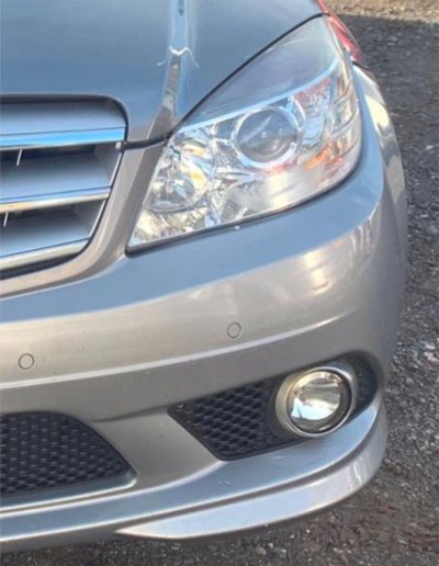

Here's a 2009 C220 S204 with Sport/AMG pack:

^+1. Someone has replaced the pre facelift bumper with a facelift one.
I have a 59 plate C Class with AMG styling and replaced the fog light earlier this year with this one,
Easy access is removing the wheel arch liner and unscrewing it from behind.

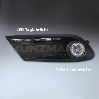

I have spent hours searching the web for aftermarket ones like mine with much luck. The closest I have found were these from Piecha.
I must admit I had a noodle about the www the other day looking for ones like yours, but even the likes of AliExpress didn't come up with anything.
That looks spot on.
Well done.
