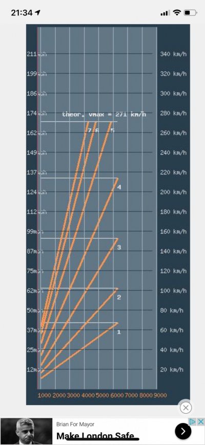

I've been looking at a website which indicates the theoretical top speed of my car and it seems as though it could hit 168mph, when eventually we are allowed back to Germany.
My car hits an indicated 160mph/258kmh at 4,650rpm, with the red line at 6,000rpm, so there is capacity.
Any ideas on how this can be done?
