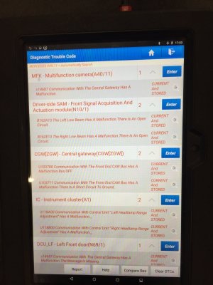

AF9E6552-9981-41FC-BFDC-DB42CB62CFF8.jpeg That sounds interesting. One of the fault codes says “can bus front end malfunction”
Wasn't there a recent thread where a faulty blind spot assist took out the CAN bus and caused all sort of errors to be randomly recorded?

Does indeed sound like a "global fault" pulling down the canbus and flagging errors where there are none. Usual causes are wiring/connector faults or water ingress somewhere on the system.

I am aware of the radar sensors on the front of the car. My car has them and they are behind the MB sign on the grill. They do not have anything to do with blind spot assist and are for collision detection. I am not convinced that the car would have blind spot assist sensors at the front as they will be pointless in detecting cars coming from the sides and behind. If anything there may be additional sensors in the doors.
My suggestion would be that you get the car diagnosed with the MB SDS system if you have not done so already. That would take any guess work out and help pin point the issue.
