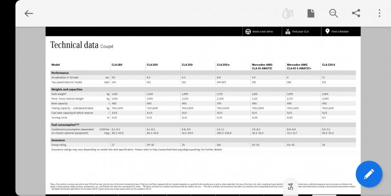

The specs say all cla250e having a towing capacity of 750/1600(2000 for saloon).Screenshot_20210311-151638_Acrobat for Samsung.jpg

If it’s a physical car then check the plate in the door shut for the approved towing weight, and if it’s a brand new car then ask the dealer to confirm the type approval in writing before ordering.
