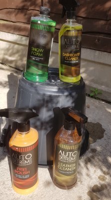

The guys are going to love telling you there cleaning methods,and do not get them onto clay bars and mopping,it could well result in the longest thread of the year,when I get the photo on my laptop I will put up the products I use and their cost :cool:
