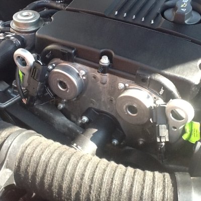

Check the electrical connections to the cam magnets on the front of the engine for oil
The two round things on the top front
Hi! Thanks for the tip, I just checked and there did not seem to be any oil in there or comming from there.
