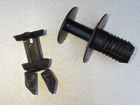

I have soldered the wires back together, and in a short time I will attach the battery and see what happens. But does anyone know what these clips are called and where to buy them? Because I mullered one or two taking them out 🤦😄

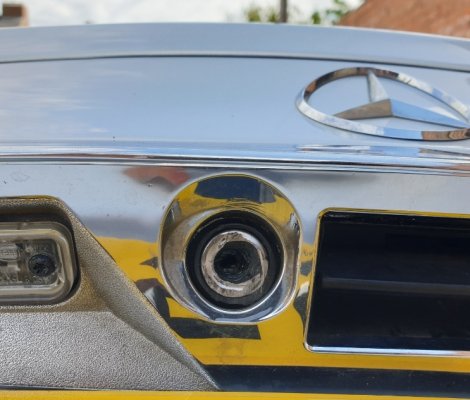

Just noticed that the manual lock has been drilled ffs🤦 Could it be that the lock is set in the permanently unlocked position? Pic attached. Cheers
The manual boot lock has no impact to the central locking.
Treat it like an override switch, with the correct key, it will pop open the boot lid whether the car is locked or not.
To work it, insert the key, turn the key 90 and then pull the black lever on the right, the boot lid will manually unlock.
Yep i understand it's just that mine has been drilled so there's just a hole where the key barrel was. No idea why
