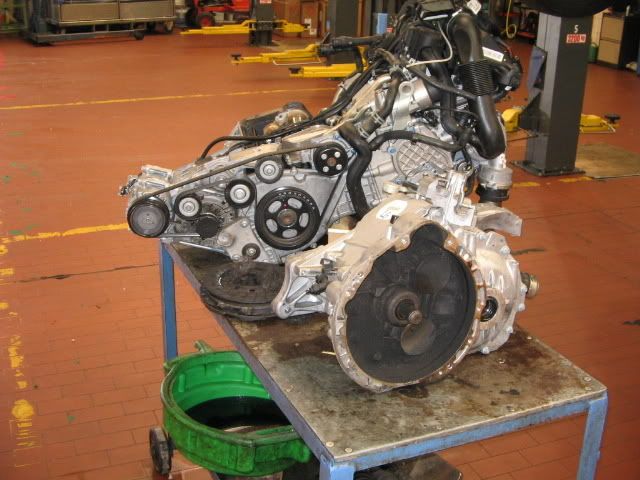

This will be the CSC (slave cylinder) gone. A drive-train out job.

Valeo and LUK are both good brands.
Definitely fit a complete 3 part clutch kit while the box is out, it's only about 10 minutes more labour.
That box in my pic was a failed CSC, it's always the CSC.
